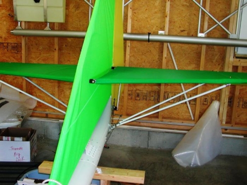

Brief Description:  Horizontal stabilizer struts

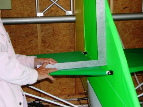

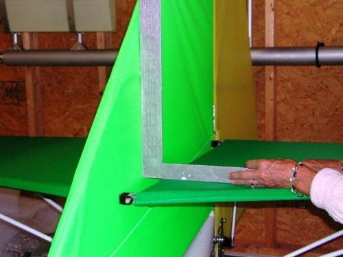

Adjust length of horizontal stabilizer struts HS-3 such that when bolted in, the horizontal stabilizer is perpendicular to vertical stabilizer. Secure temporarily into place with AN3-6 drilled bolts. Drill out 3/4" wahers to 3/16" as push rod bearing end washers.
Tail surfaces are perpendicular (L)
Right
Right
