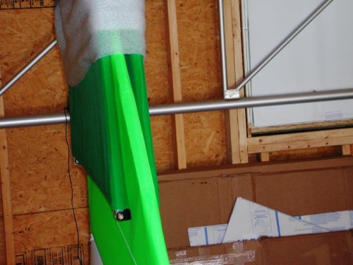

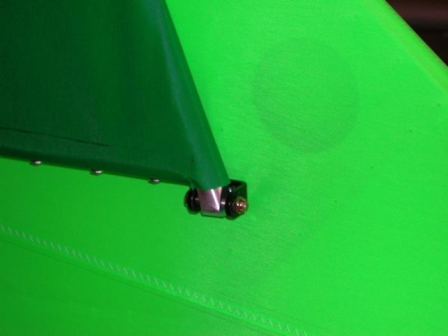

Fit horizontal stabilizers to vertical stabilizer and bolt into HB-16 brackets. Grind down fittings so tail can completely fold up. Secure into place with AN4-15 drilled bolts, castle nits and cotter pins.

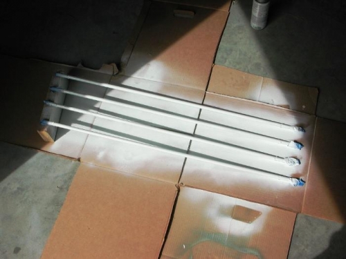

Spray paint tail struts and folding elevator hinge.

Leading edge of horizontal stabilizer
Painting tail struts
Folded horizontal stabilizer
