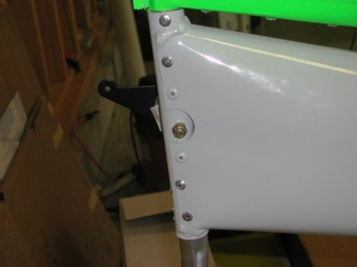

Drill 3/16" holes in boom tail post and secure vertical stabilizer with HM-16 3/16" rivets with 6 on each side totaling 12.

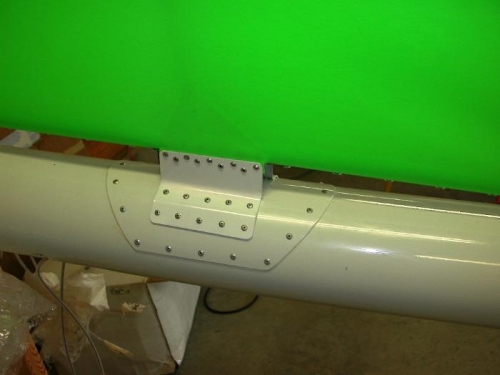

Reinforce HB-17 and HB-18 brackets with an extra row of 1/8: rivets.

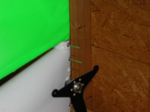

Riveting tail post
Securing elevator horn onto post
Reinforcing vertical stabilizer brackets
