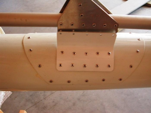

Install HB-17 (right only) between boom and leading edge of vertical stabilizer, allowing for offset 1'2" to the right, with 1/8" long rivets. Do same with HB-18 boom bracket (right only).

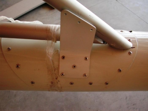

Right forward vert. stabilizer mounting bracket
Right center tail bracket

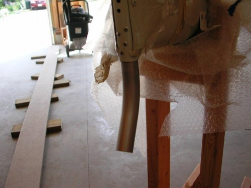

Tail skid riveted in place
