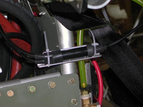

Brief Description:  Fuel Control Cables
Throttle
Fabricate mounting bracket for throttle cable splitter out of 3/4" x 1/16" Al angle stock approx. 3" long. Drill mounting holes and bolt to engine block. Secure splitter with 4" nylon cable ties.

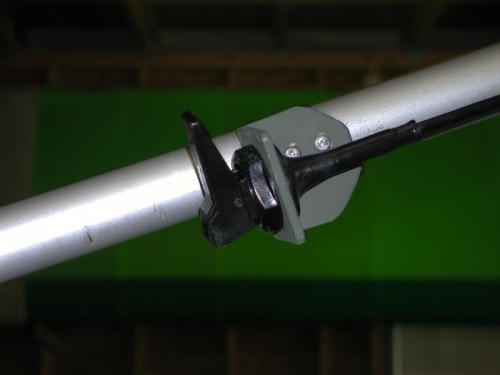

Choke
Fabricate mounting bracket for choke cable splitter from 3/4" x 1/16"Al angle stocck approx. 4" long and rivet to airframe on vertical support tubeon right side of fire wall with 1/8" rivets. Secure splitter with nylon cable ties. Secure choke handle mounting bracket upper right fuselage support tube attach handle with nylon nut supplied with choke.
Choke cable splitter
Throttle cable splitter
Choke control
Choke control
