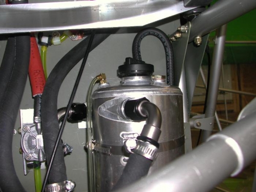

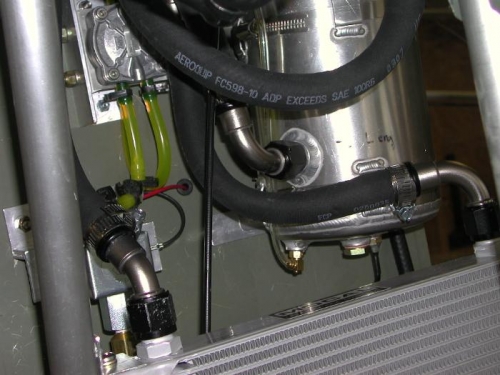

Locate and route high pressure oil hoses from engine to sump tank to cooler as directed. Cut hoses to length, lubricate ends of fitting with lithium grease and press fit hoses onto barbs of fittings and secure all with 1" stainless steel hose clamps. Fabricate oil vent line from 5/16" ID pessure hose and secure onto tank with 5/8" hose clamp.

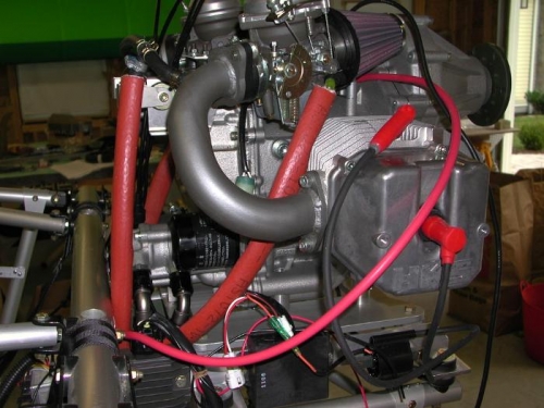

Cover fuel lines near oil system and enging block with fire sleeve. Secure to carburetors and vacuum pulser line with Snap-its. Make sure all connections are secue
Oil hoses
Oil hoses
Flame sleeves
Flame sleeves
Oil tank vent line
Oil tank vent line
