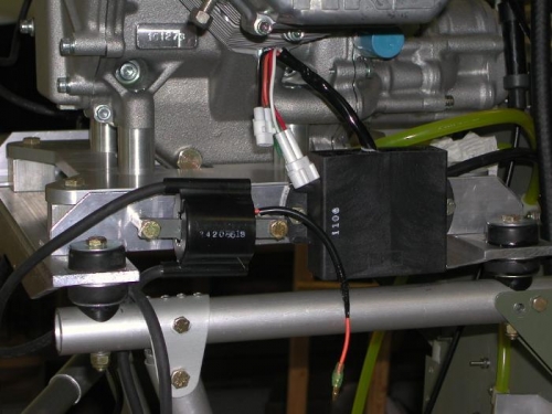

Repeat above for right side components using a 12" bracket. Secure right CDI and coil tihe AN4 bolts and locknuts. Ground electrical system using 6 ga. cable from Hot Box to this bracket.
Right ignition components
