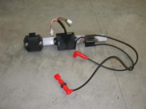

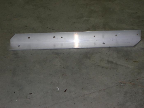

Locate positions for voltage regulator, both CDIs and both coils and fabricate mounting brackets from 1-1/2 x 1/8 Al angle stock, 14" long for regulator, CDI and coil. Secure to engine mounts with AN4 bolts and locknuts. Secure left VR< CDI and coil to bracket with AN4-11A bolts and locknuts. Coil uses aluminum standoffs and AN4-20A bolts.
Ignition component mounting bracket
Parts on bracket
Parts on bracket
Left side ignition parts
