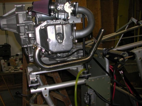

Muffler Mounting Bracket
Assemble muffler bracket and bolt to engine block in 4 places using 5 mm hexhead bolts and bushing with blue lock-tite on threads. Loosely mount exhaust pipes for placement.
Exhaust pipes located
