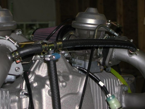

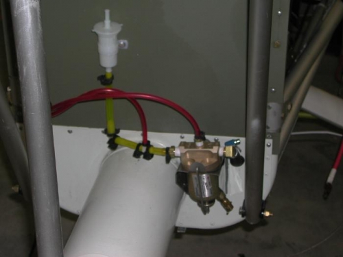

Attach primer tubing to gascolator and "T" fitting in fuel line. Run urethane fuel line from output of electric pump to input of vacuum pulse pump. Run line from output of vacuum pulse pump to a splitter and then line from each side of the splitter toward the carburetors. Secure fittings with nylon hose clamps bolted to the fire wall.
Revise vacuum pulse port from intake manifold pepes to move the "T: off center to line up with fuelpump pulse port and avoid interference from the muffler. Run vacuum line down from the "T" to the pump.
Primer tubing connected
Vacuum pulse line relocation
