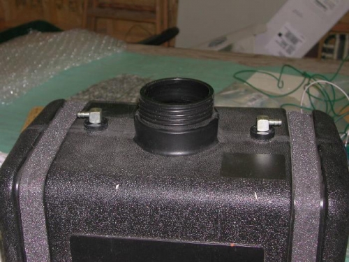

Attach fittings to gascolator as follows using teflon thread tape:
Gascolator input. 1/4 NPT male to 90 deg elbow 5/16" barb.
Gascolator output. 1/4 NPT male to straight 5/16" barb.
Gascolator primer. 1/8 NPT male to 1/8" barb out.
Tank fittings. Drill 9/16" hole on bottom and install Leading Edge Tank Bushing part no. H7264 and tighten as per enclosed instructions. Connect 1/8 NPT elbow to 5/16" barb, the 5/16" ID neoprene reinforced gas tubinng to 5/16" "T" splitter, down to drain valve using tubing and 5/16 barb in and 1/4" barb out drain side. Connect other end of "T" to 5/16 line to gascolator input port through grommeted holes in aft bulkhead.
Drill out and install 2 9/16" rubber bushings on upperpart of tank with 5/16" elbows to 1/4" barbs for lined from wing tanks.
Main tank bottom bushing
Main tank top bushings
