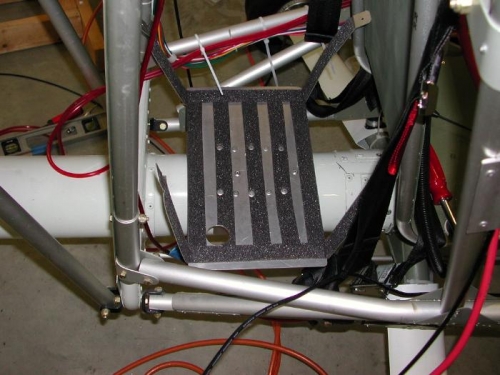

Locate exit port position on bottom of main tank and drill 1-1/4" hole in mounting bracket at corresponding position.. Secure tank bracket to root tube with 3/16" rivets.

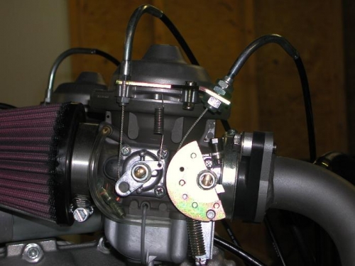

Connecct choke and throttle cables to carburetors and run cables back to cocpit. Throttle on left, choke on right.

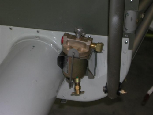

Gascolator: Fabricate gascolator mounting brackets from 3/4 x 1/8 Al angle stock and spray prime. Secure brackets to aft sside of reaar bulkhead with 1/8" rivets (4) and secure gascolator fraame to brackets with 4 1/8" rivets.
Main fuel tank mount
Throttle/choke cables at carburetor
Gascolator mounted on aft bulkhead
