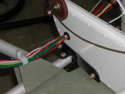

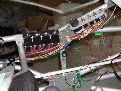

Brief Description:  Ignition Wiring
Bundle ignition wiring and run it aft from switches to firewal using nylon cable clamps secured with 3/16" rivets. Run bundle through 3/4" hole drilled through forward bulkheaad and insulated with 1/2" rubber grommets. Run RADC cable forward from firewall to instrument panel through same holes and grommets.
Bundles wires
Bundles wires
Bulkhead through wiring
