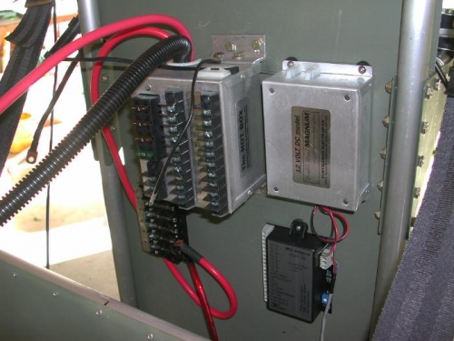

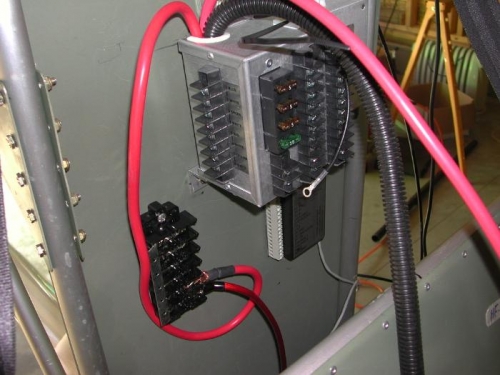

Brief Description:  RADC Box, strobes
Mount MGL RADC box, strobe controls and 12 V terminal block on forwaard side of fire wall using stainless steel screws, nuts and lock washers. Connect battery positive lead and Hot Box to 12 V terminal block. Mount engine ground cable to aft side of fire wall on one of the AN3 bolts that hold the Hot Box to the fire wall. Note, strobe box and RADCwere shock mounted with rubber washers.
Firewall forward side
12 V terminal block
12 V terminal block
