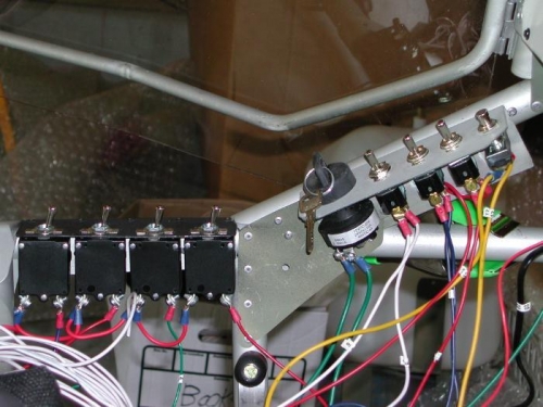

Brief Description:  Ignition and EIS Wiring Continued
Complete the wiring for the ignition switches, Mag L & R and start. Wire MGL EIS and Accessory plug to terminal block. See legend for wiring color, specs and numbers.
Measure resistance across various parts of airframe to check ground characteristics. All shorted and OK. Note engine is isolated from airframe by Berry mounts and must be connected to airframe with ground cable.
Mount MGL/ACC terminal block to airframe brackets and complete connections.
Ignition switches
Ignition switches
