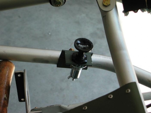

Fuel Primer
Mount primer bracket to left lower inside of cockpit woth AN4-14A bolt in existing holeand secure with steel washer and locknut. Secure primer pump into place. Note: input port is angled outward; output port is straight down.
Fuel primer pump
