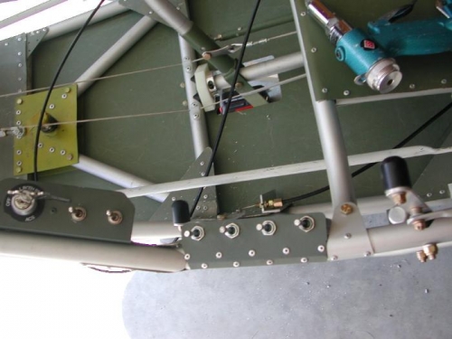

Prime and install switch/breaker mounting plates on left side rail of forward fuselage. Test mount the following switches/breakers: Lights (position 2A, strobe 5A, landing 5A); avionics/acc/ (5A); Master; fuel pump, starter (mags and starter);

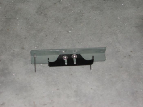

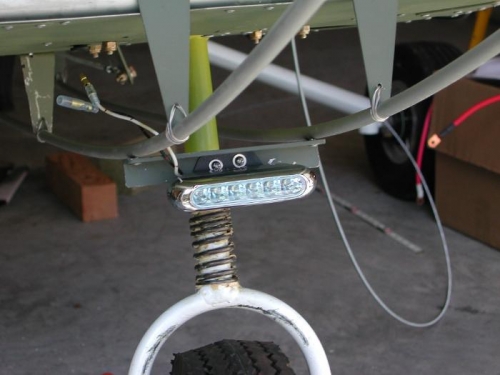

Revise landing light mounting bracket to bottom stringer tubes. Test fit LED light fixture.
Light switches/breakers
Revised landing light bracket
Llanding light test fit
