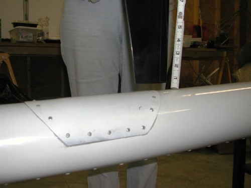

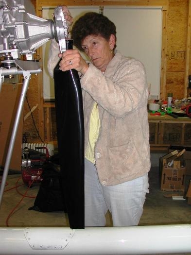

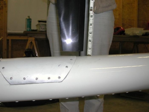

Telephone conference with Dana Persiani of HPower Ltd. Engine as delivered has redrive prop shaft in low or bottom position, which only allows fraction of inch clearance between prop tip and boom tube. HPower Ltd., which shipped the engine, agrees on phone to rotate redrive to upper or top position if I deliver engine to them in CT. They will order new gasket and make the revision to the engine next week or when gaskets come in.
Lower output redrive
Prop tip clearance too little
Another view
Another view
