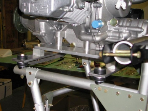

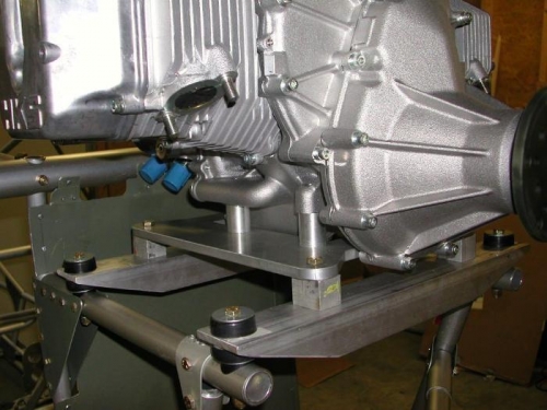

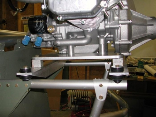

Engine support blocks
Per instructions from CGS, install HKS-1 blocks between engine mounting plate and cross braces. Sucure with AN5-20A bolts and locknuts (4 each).
Insert 3/32 x 7 x 7 contol cable into left rudder control cable guide.
Loosely attach muffler to engine with supplied exhaust pipes for fit and location.
Left rear engine mount
Left side
Right side
