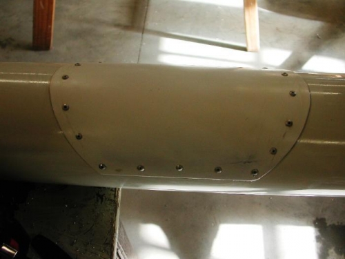

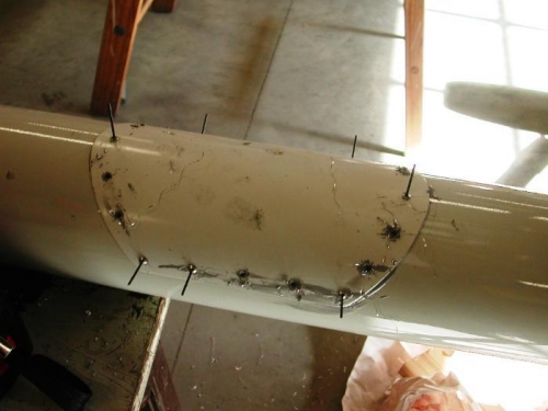

Mix marine epoxy and apply to inside of HF-110 doubler plate. Secure to boom tube beneath location of rear engine support tube with 1/8" HM-14L rivets.

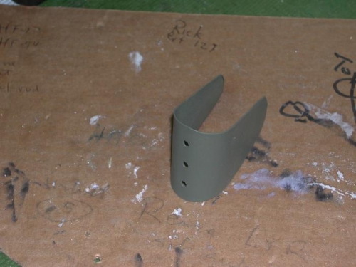

Fabricate U-bracket from sheet steel and spray with primer. This bracket will be used to attach HF-121 vertical tube to center of HF-122 curved cross brace
Fabricated and primed U-bracket
Doubler plate in progress
Finished doubler plate
