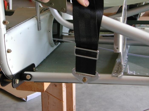

Fwd. Lap Belt
Locate position for fwd. lap belt mounting bolt 7" forward of bulkhead and drill 1/4" mounting holes on side rails HF-12B (L&R). Secure with AN4-14A bolt, steel washer and locknut (L&R)
Aft Lap Belt
Locate position for aft lap belt mounting bolts 11-1/4" fwd of aft bulkhead and drill out to 1/4" on HF-67 side rails (L&R). Secure with AN4-14A bolts, steel washers and locknuts.

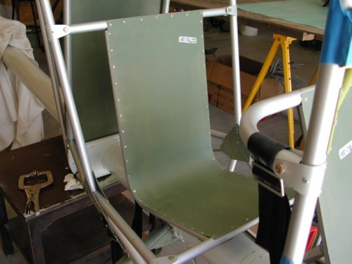

Aft Seat
Locate aft seat HF-76 against seat rails and drill out and secure with HM-14 1/8" rivets (40).

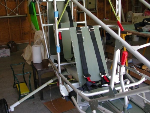

Fwd. Seat
As above secure fwd. seat HF-72 to rails with HM-14 1/8" rivets (40).
Aft seat belt mount (R)
Aft seat
Aft seat
Fwd seat with restraints
