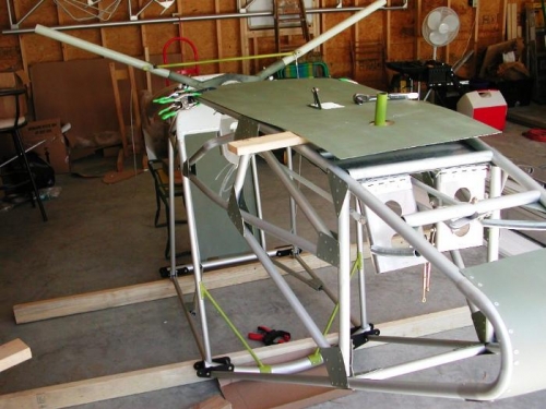

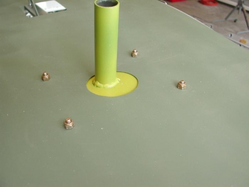

Flip aircraft onto its back. Fit floor panel to bottom of fuselage. Drill 3/16" holes (4) corresponding to location of nose wheel steering knuckle bolts and replace with HH-19 (AN3-14A) bolts and secure with nylon locknuts.
Bolt floor panel to nose wheel knuckle
All 4 bolts secured
