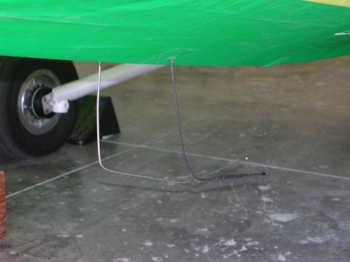

Locate position for ELT and Comm antennas, make hole in fabric with hot knife and mount antennas into place beneath floor pan grounf planes. Patch holes in fabric.
Secure landing light bracket to belly stringers forward of nose wheel with 1/8" rivets, snake power wires through fabric and connect to lights. All test OK.

Comm and ELT antennas
