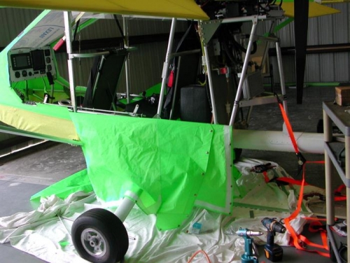

With fabric under tension, locate position of snaps on diagonal engine mount tubes. Drill ot and rivet male snaps into place with 1/8" rivets (7 on each side) and snap into place.

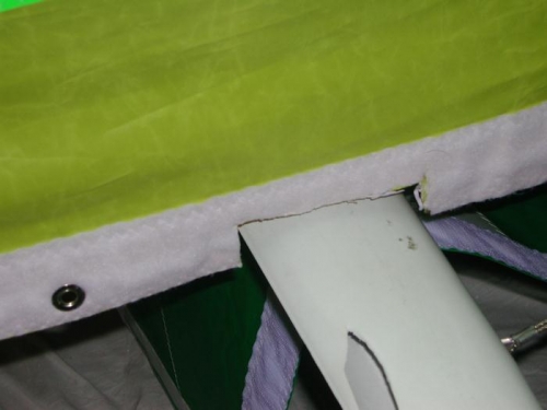

Trim fabric around main gear legs (L&R) and cut access panel into underside of nose for pitot tube.
Aft door fabric cut out
