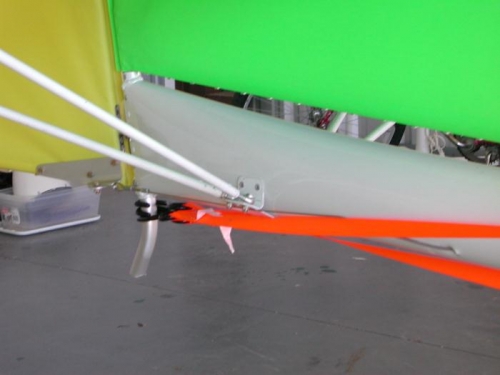

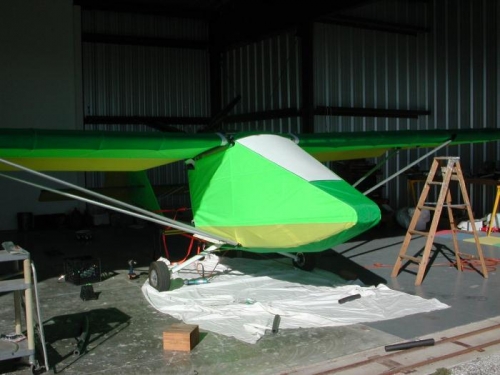

Fabricate Al strip to clamp fabric for stretching with ratchet clamps. Locate side cabin stringers and stand-offs to align with seam in fuselage fabric. Test fit fabric to nose, remove nose wheel, and slide fabric over toward aft. Secure side stringers to standoffs, riveted to fuselage, and flatten ends and rivet to sides of nose former and aft fire wall suppor tubes. Start pressure on ratchet clamp straps connected to Al strip clamps on fabric and tail wheel skid,
Initial stretching
Initial stretching
Ratchet straps on fabric
On tail skid
On tail skid
