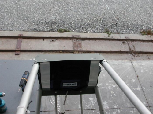

Brief Description:  Add Weight to Nose
Fabricate mounting bracket from 2" x 1/16" flat Al stock for canvass weight bag in nose former. Add 20lb of lead shot diving weights to bag and secure into place with 1/8" rivets. Recalculate CG based on added weights results in 34-38 % of wing chord loadedd--within CGS factory specs.
Weights added to nose
