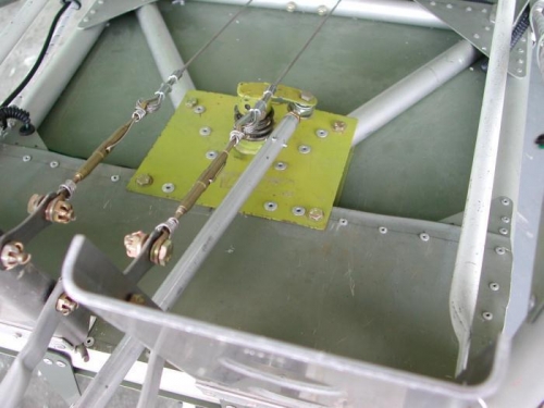

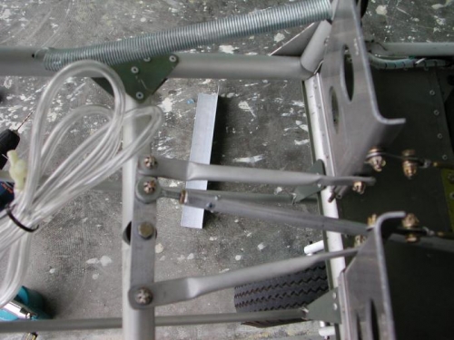

Lengthen nose wheel steering push rod to give better range of motion by cutting a new length of 1/2" Al tubing and installing bearing ends on each end to nose wheel steering crank to link to bedal cross pivot bar. Secure with bushings, AN3 bolts, wahers and locknuts. Tighten retaining lock nuts.
Lengthened steering push rod
Forward view
Forward view
