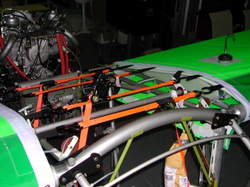

Using ratchet straps, tightern inboard edges of wing fabric using straps sewn into fabric as connection points. When tight, tie wing fabric together with 1/8" nylon line supplied by manufacturer. Remove excess fabric from around hinges using hot knife.
Ratchet straps applied to wing fabric

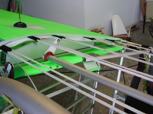

Tied with rope
Tied with rope

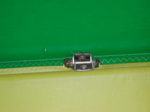

Excess fabric removed from hinge area
