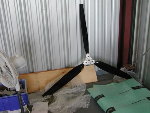

Brief Description:  Initial Test Fit
Assemble prop blades (3) into hun castings. Dry fit prop and set rough initial pitch using .065 of feeler gauges. Torque prop blade mounting bolts to 175 in-lbs. Bolt assemble to prop flange on engine. All fits. Remove prop assembly and set aside for final installation.
Powerfin prop
Powerfin prop
