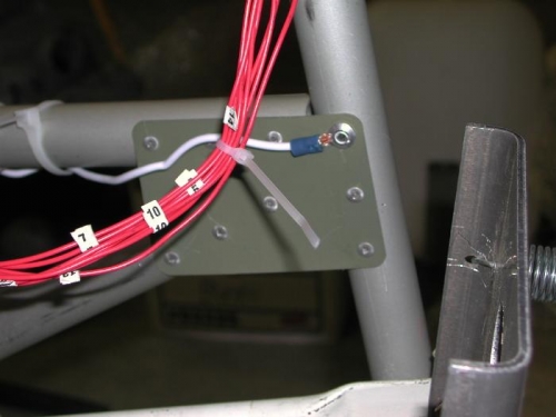

Brief Description:  Terminal Block/Lights and Avionics Buss
Ground avionics terminal block to fuselage with 3/16" rivet to nose frame. Perform continuity check from ground to all parts of fuselage frame (OK) and run power buss line for lights and avionics power back to Hot Box. Secure with nylon cable clamps and ties.
Avionic/lights ground connection
