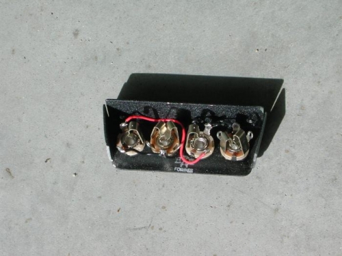

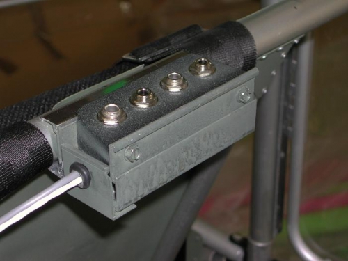

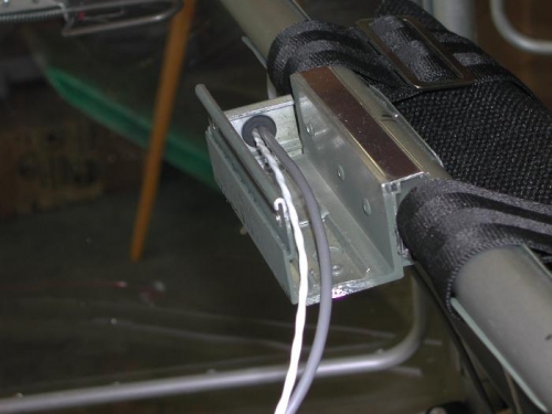

Brief Description:  Dual Headset Connections
Run mics 1 and 2 (cable 1,2,3) and common headphone cable from comm./radio harness aonnection Diagram and solder into place. Secure with 5/16" sheet metal screws and apply labels, Note on mic plug, audio is one up from the tip. Tip would be used for PTT function but that is stick mounted.
Jacks wired
Jacks wired
Feed cables
Feed cables
Completed headset jacks
