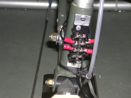

Brief Description:  Push to Talk Switch
Butt splice 20g black wires to PTT switch wires and snake down inside of forward control stick. Fabricate terminal block mounting bracket and secure to base of control stick with 1/8" long rivets. Secure PTT wires to terminal block. Run PTT wires (black) along floor pan to front of cockpit behind instrument panel.

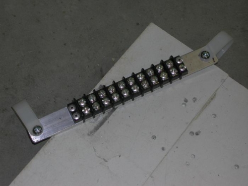

Fabricate mounting bracket for 10-pole terminal block for radio from 3/4 x 1/8" Al flat stock, 2 nylon Adel clamps. Rivet terminal block to bracket with 1/8" long Al rivets.
PTT on fwd control stick
PTT terminal block
PTT terminal block
