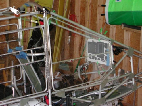

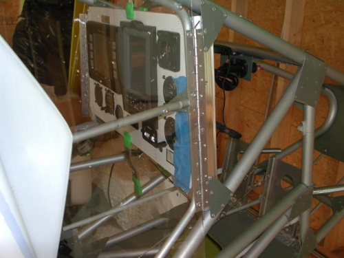

Finish riveting Lexan glazing to door frame as above. Trim aft edge of Lexan. Using dremel cutting disc, remove latch handle exterior projections from left side door frames. Left hand doors will be used as emergency exits only, openable from interior of cockpit.
Fwd door right
Fwd door right
Fwd left door hinge
Fwd left door hinge
Door done
Door done
