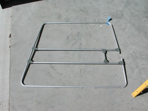

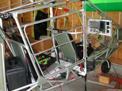

Fabricate aft door frames by adding a second stiffener and cut out a section of tubing to clear the forward seat upper mounting bracket on the hinge sides of frame. Cut 8 additional HG-4 gussets from 0.02 Al sheet and secure together with 1/8" rivets
Aft door added stiffener
Test fit aft door
Test fit aft door
