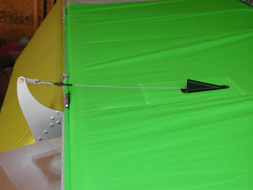

Right Wing Finished
Melt out slot on bottom and runf lower aileron cable to horn through a plastic fairlead riveted into place over the slot with 1/8" rivets an backer plates (5 of each). Repeat for upper surface and then wrap both cable ends with padding.
Lower aileron cable exits wing
Another view
Upper aileron cable
