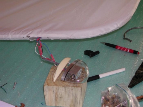

Install wing-tip position and strobe lights as per Kuntzleman instructions.

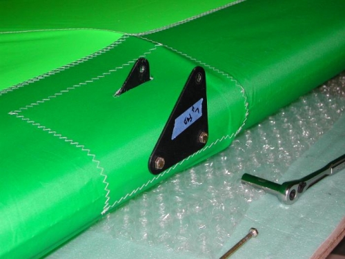

Re attach right aileron and melt 1/4" holes in cover for leading aand trailing edge strut brackets.Mount sturt bracket and aileron pulley assembly on inside of leading edge and secure with 1/4" bolts, steel washers and nylon locknuts. Mount aft strut bracket in similar fashion.

Assembling wing-tip lights
Fitted strut brackets
