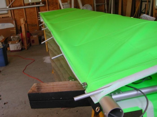

Re-attach hinges for aileron and flap and re-attach wing-tip light mount. Secure fabric at leading edge of wing root with a 3/16" rivet through the grommet.

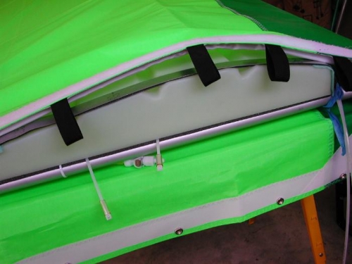

Fabricate and install upper wing battens as with left wing. Trim to length and snap into place.
Re-attached wing-tip light mount
Upper battens in progress
Upper battens complete
