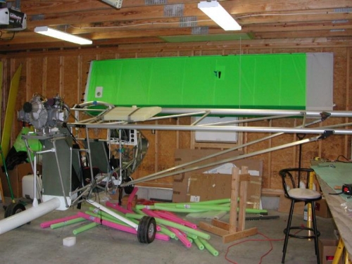

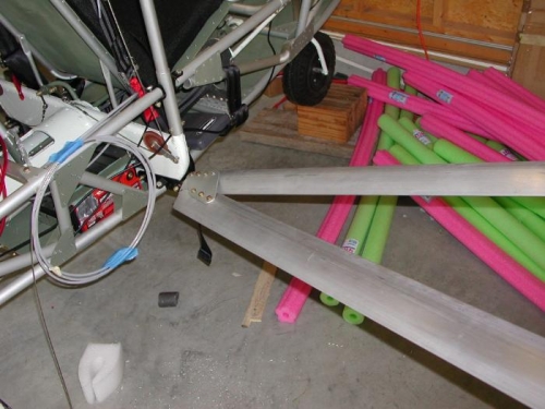

Brief Description:  Right Wing Struts
Bolt right wing frame to fuselage and attach forward strut. Chech dihedral and washout angles to confirm about 4 degrees. Attach aft strut to wing and trim about 1/2" fro leading edge at fuselage end. Drill out 3/16" holes and secure aft strut to mounting bracket with AN3-15A bolts, steel washers and nylon locknuts.
Right wing frame
Right wing frame
Wing struts fuselage end
