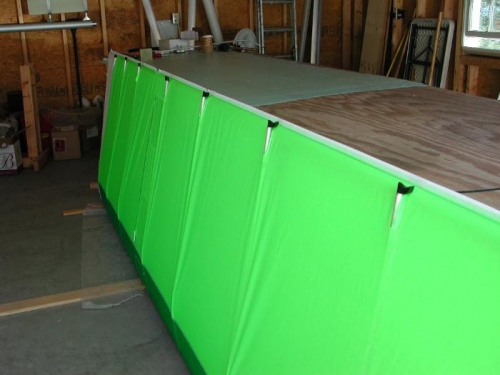

Brief Description:  Left Lower Battens
Clean and insert HW-10 nylon tips into leading end of HW-7B lower wing battens. Secure by dimpling tubing with a punch. Insert into fabric pockets in bottom side of wing covering. Trim aft end of tubes about 1-3/4" each, insert HW-11 trailing edge tips and snap into place, foring upper and lower air foil shape of left wing.
Aft ends of lower battens
