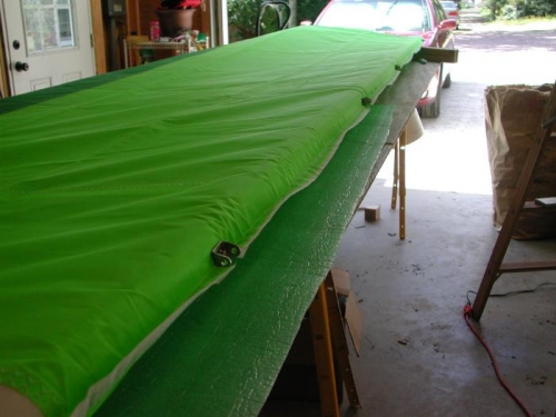

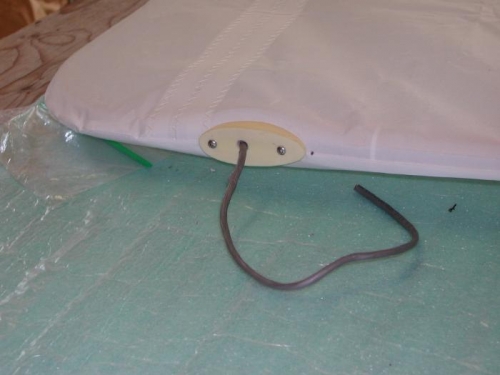

Having stretched fabric overnight, fish out strobe wires and install socket for left wing tip lights. Locaailing edge velcte and burn through mounting holes for aileron and flap on trailing edge og wing and strut brackets on leading and trailing edges. Bolt in the hinges, after cutting away some trailing edge velcro.

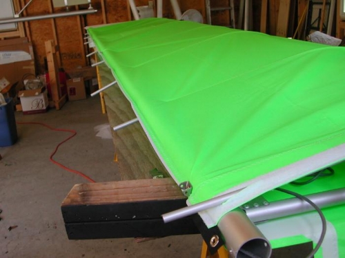

Assemble upper battens HW-7 with HW-10 leading edhe tips and dimple with aa center punch to lock them in. Insert battens into pockets inside wing covering. Push in and trim the aft end of each batten to side, insert trailing edge tips HW-11 and snap into place.
Wing tip light wire
Wing tip light wire
Trailing edge hinges
Upper battens
Upper battens
