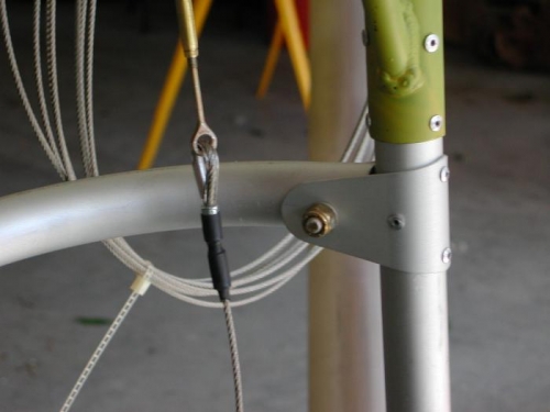

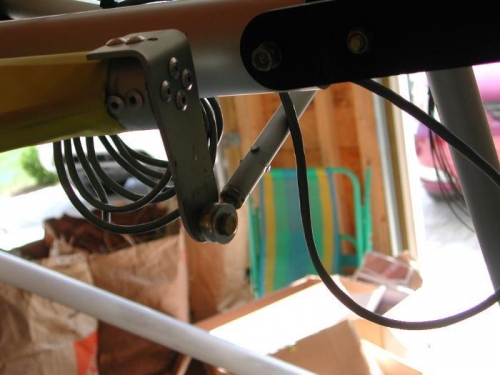

Do fine adjustment of left flap pushrod length and test fit with AN3-5 drilled bolt, washer and castle nut. Reswage control cables onto side cabin turnbuckles for better finish as shown by tech counselor.
Test fit flap push rod
Revised swage with shrink tubing
