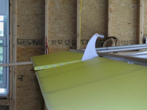

Brace aileron with long wooden board to 0 deg position for comparison to flap, which is to be set so that trailing edge of flap is about 1/2" belop trailing edge of aileron. Shorthen pushrod by about 6" and resecure threaded insert with solid Al rivets. Attach to flap horn so that proper alignment of flap is achieved. Shorten right wing push rod in similar fashion.
Correct flap alignment
