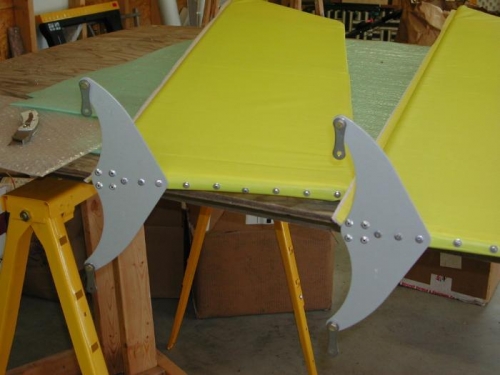

Aileron Horns
Tighten aileron fabric with lengths of wooden dowling. Secure aileron horns HC-6TP (L&R) to ailerons ribs (see Dwg. 14) with HM-16L and HM-16 3/16" rivets as indicated.
Secure hinges (4) to leading edges of ailerons with HH-9 AN3-17A bolts.
Aileron horns
Horns riveted to ailerons
