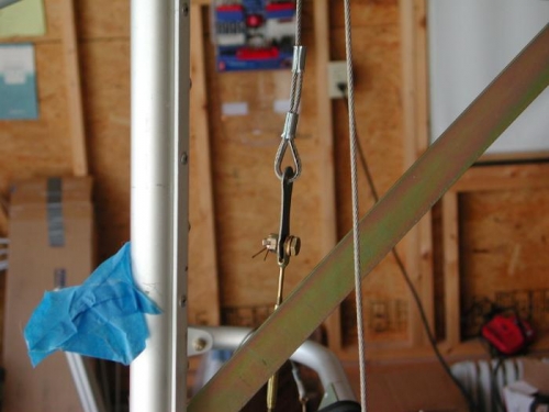

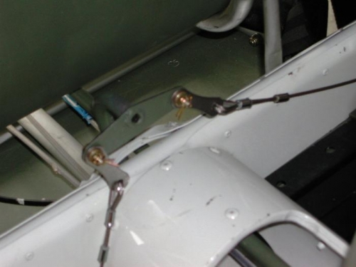

Cut two 50' lengths of 3/32x19x7 control cable and swage ends to tangs on aileron bell crank. Swage other end of each cableto loop end of turnbuckle (L&R) and attach tangs with AN3-5 drilled bolts, steel washers and castle nuts. Loosely insert cotter pins into each bolt.
Cabin end of aileron cable
Cables swaged to aileron crank tangs
