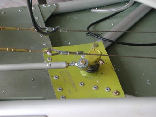

Nose Wheel Steering Crank Revision
Add 1" retaining washer to nose wheel steering push rod bearing end. Replace bolt into place with an AN3-7 and resecure with castle nut
Washer added to push rod
