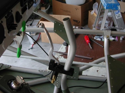

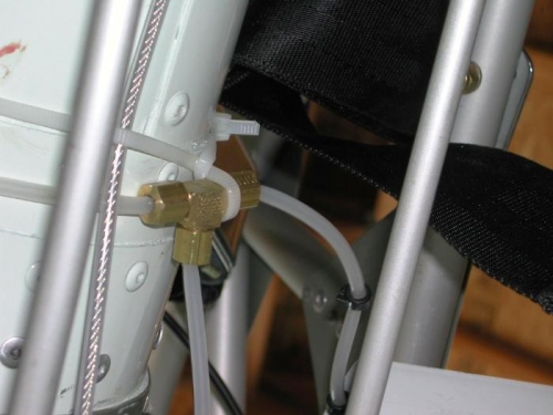

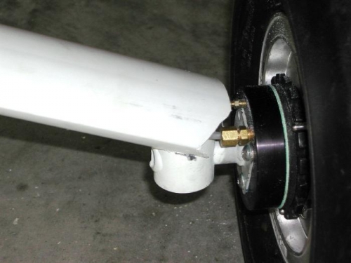

Install hydraulic brke control and master cylinder on forward control stick. Attach 3/16" OD nylon brake line to master cylinder with 3/16" compression fittings and run line aft to main gear mounting yoke. Secure to under belly with LG-23 cable clamps riveted with 3/16" HM-16 rivets to fuselage cross bars. Run brake lines inside main gear streamlined fairings to disc brake units on main wheels (L&R) and secure with compression fittings. Using HP-131 "T" compression union, secure line from master cylinder to lines for both wheels. Secure all lines in place with nylon cable ties.
Control and master cylinder
Brake lines at disc brake unit
Brake line splitter
Brake line splitter
