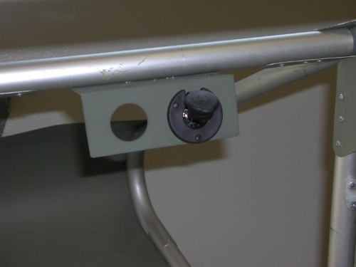

Fabricate behind-the-panel power plug bracket from 2"Al angle stock. Prime, drill and secure to nose upper cabin cross brace with 1/8" HM-14 rivets (6). Test fit power plug.
Bracket for GPS power plug
Test fit power socket
