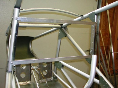

Fabricate top and bottom mounting brackets for instrument panel with 3/4"aluminum flat stock and secure to forward door posts with 3/16" HM-16 rivets (L&R). Drill mounting holes for panel screws along top and bottom edgess for 4-40 x 1/2" stainless steel screws and nuts.
Top and bottom support brackets

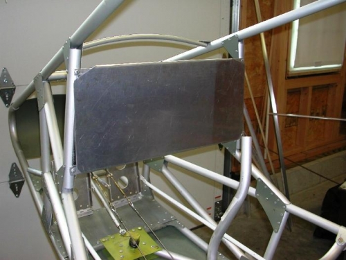

Test fit preliminary inst. panel
