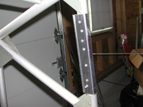

Fabricate side mounting brackets for instrument panel out of 1/2" x 1" aluminum channel stock approx. 7-3/4" long. Rivet into inside of forward door posts (R&L) with HM-14 1/8" rivets (4 on each side).
Panel side mounting bracket
Another view
