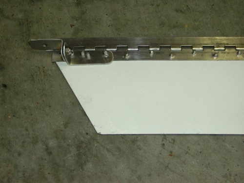

Trim tab fabrication
Fabricate trim tab with piano hinge and bell crank secured together with HM-14 1/8" rivets (17) and secure to trailing edge of left elevator with 15 HM-14 rivets.
Shorten push-pull control cable and connect to bellcrank with a cable end stop.
Trim tab mounted on left elevator
Cable connection to trim tab
Trim tab detail
